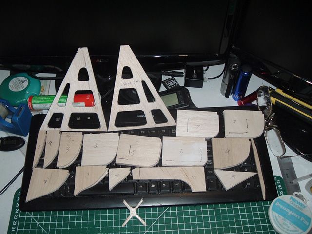

PostSubject: Re: Josie Olsen   Fri Jul 10, 2015 11:20 am
I braved the cold shed to get balsa for bulkheads and beam & gallows.
Tools req'd.
Card patterns already made.
Trusty scalpel with No 10 blade.
Assorted Balsa.
Bulkheads ready for assembly.
The Beam was very fiddly I decided on balsa as per plan as it's easier to work delicate cuts than polystyrene.
Looking good so far a little and sanding  bit of filler needed prior to a bath in polyester resin to make it solid.
Worked at my computer desk keyboard's is covered in balsa dust. lol! lol! lol!

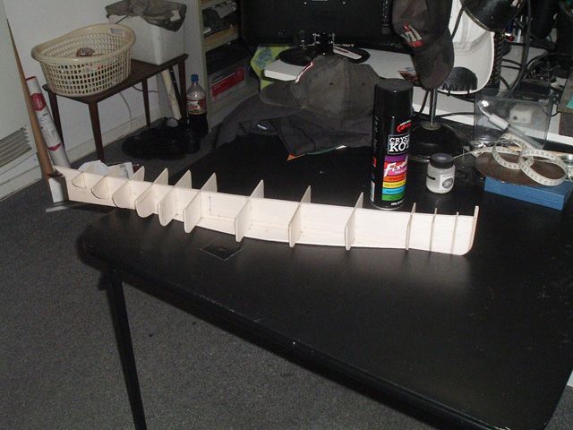

Skeleton together.
I've been banned from the lounge/pooter room for model making after the fumes from the super glue gave my other half a migraine, I can only hope for warmer weather soon after a -5.7c last night.

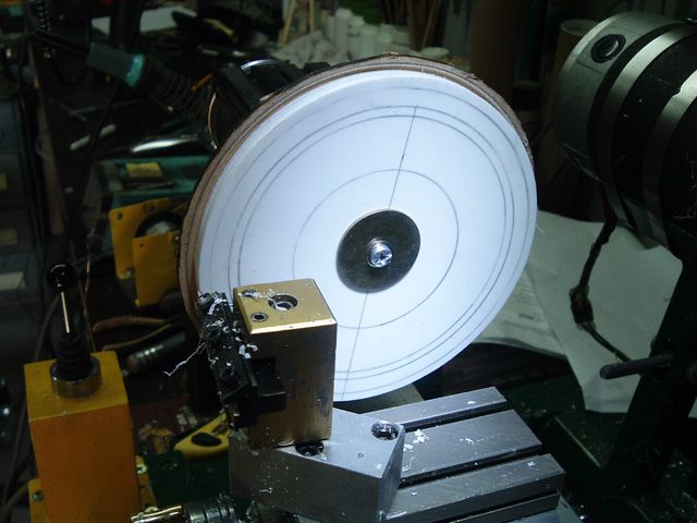

PostSubject: Re: Josie Olsen   Mon Sep 14, 2015 2:43 pm

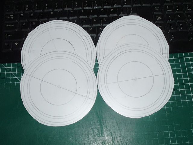

Cut the paddle rings on my lathe today a little cleaning up and they'll be fine .
4 pieces marked with compass as per plan centre drilled 4.5mm and reamed fo close fit on 5mm bolt fender washers both sides and nylock nut.
A 3mm backing was needed to stop the polystyrene warping.
All turned out nicely only a little trimming needed.

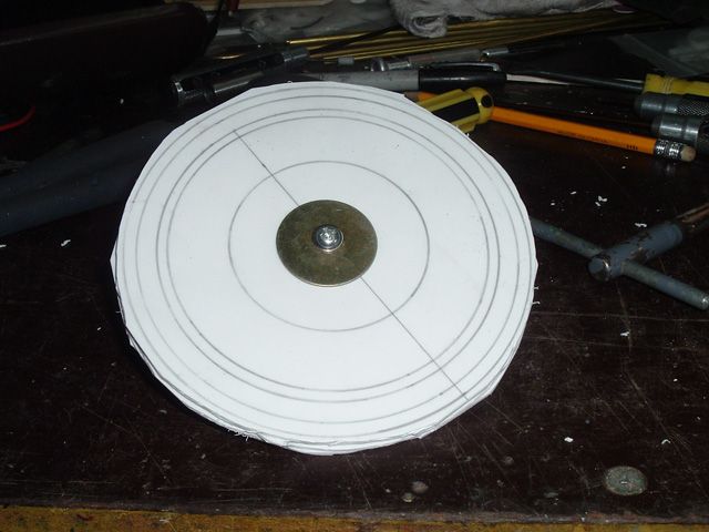

This pic shows the same 4 wheel stack in my cordless drill a power drill spins a lot faster.

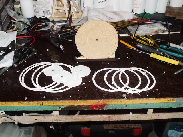

Rings trimmed, spokes cut and blades/buckets cut to size yesterday
Looking at the plan this morning I was 24-18mm x 20mm buckets short this Guillotine has made cutting polystyrene so easy.

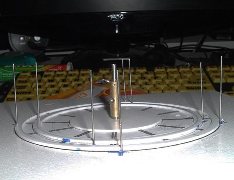

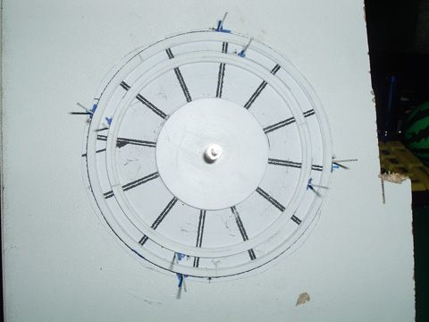

Progress wheel Jig made.
A 2.5mm hole made with drill press in some excess chip board a section of the 3mm spindle was driven in place with the drill press to assure 90% to the wheels.
The 3 rim parts 2 rings and centre were held in place whilst using a marker to show position of 1mm holes for 1mm stainless pins seen the pics all 4 rims will be exactly the same.
The brass centre will have a 12mm x 1.5mm Dia pin each end at 90 deg's to capture the the centres to avoid any slippage and also drilled and tapped 3mm for grub screws, this first one is not fully machined as yet.
